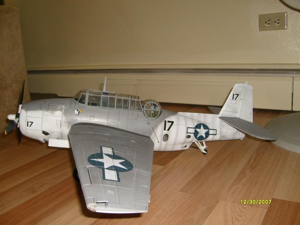

This is a WM Atlantic avenger that I did last December

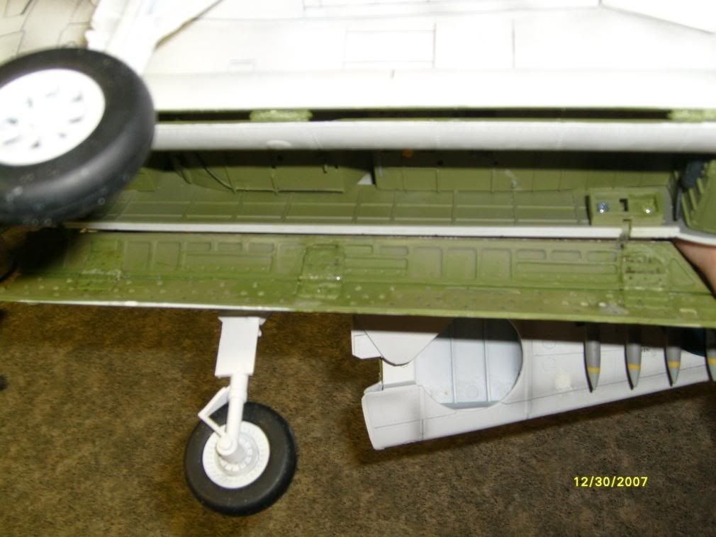

I modified the doors so they have the bi folding effect and added some detail to the wing folding mechanism, I am not done and plan on redoing the wing root and add some detail.

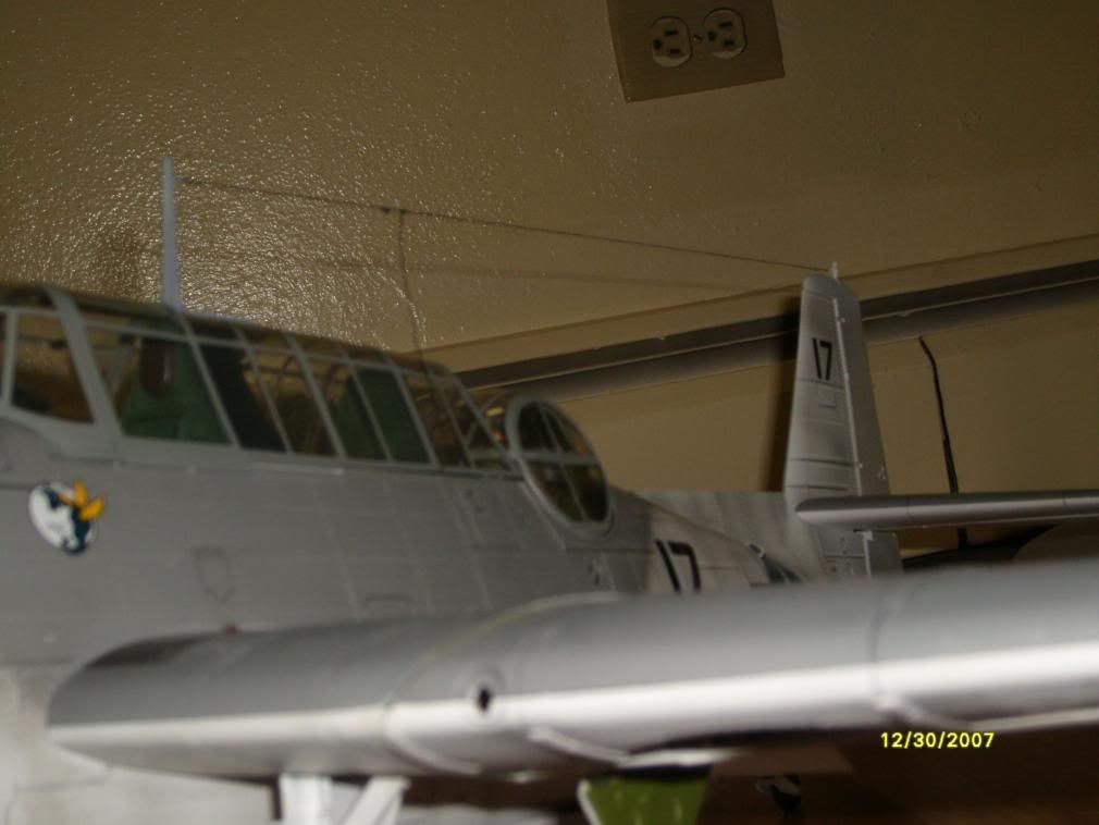

These are the antennas I made out of plastic forks.

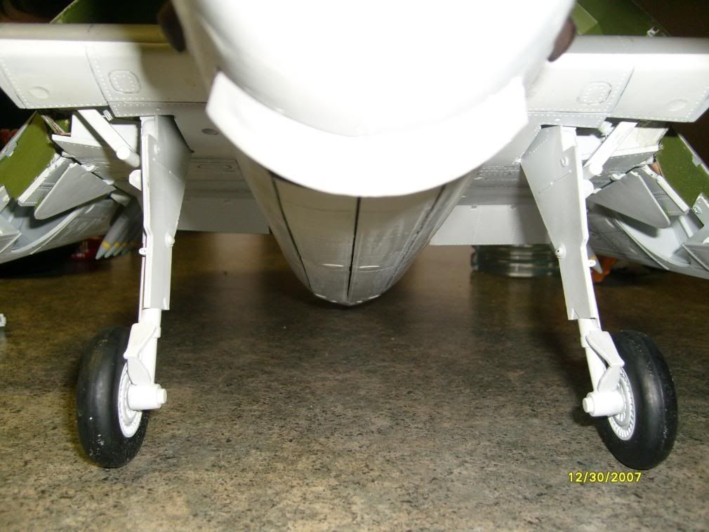

Btw the wing inserts are made out of cardboard from a fancy feast box cat food box. I plan on making some out of plastic and with more detail latter on.

I love the bomb bay doors, how did you go about re-hinging that?
Good Traders:
Olifant
Panzer M
Post by VMF115 » Sun Jan 13, 2008 2:18 am
AlloySkull wrote:I love the bomb bay doors, how did you go about re-hinging that?
I used nylon rc hinges http://www.hobbypeople.net/gallery/566588.asp
I then cut the bomb bay door while it is still on the avenger.
If you look on the inside of the bomb doors you will see where it would separate, then take a hobby knife and scourge it from the inside, till it is weak enough then you cab snap it apart…I then taped them together and used two stage epoxy...It took about 25 min and another hour to paint. But it took about 3 weeks to get the guts to do it. :lol:
