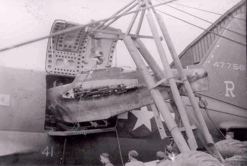

Re: 1/18 Me163B-1
Nice progress on the 163!!
YT, is that the National Air and Space Museum? Cool to see it in its orignal (?) paint scheme.
This is a Komet arriving at Freeman Field...
