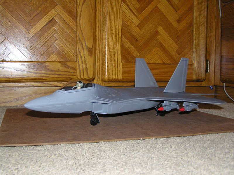

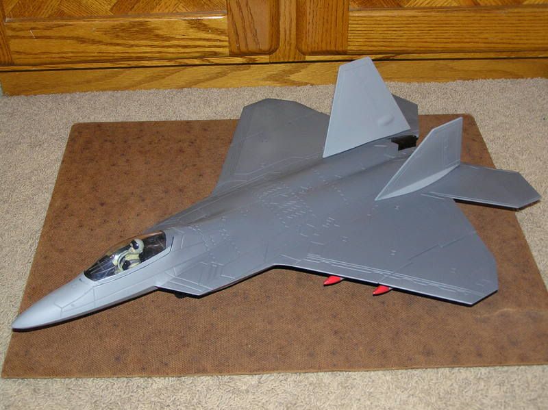

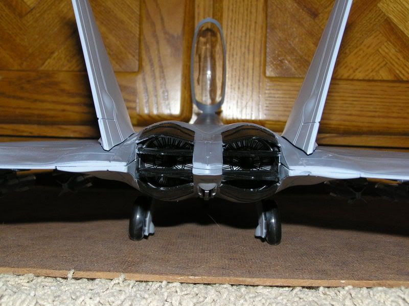

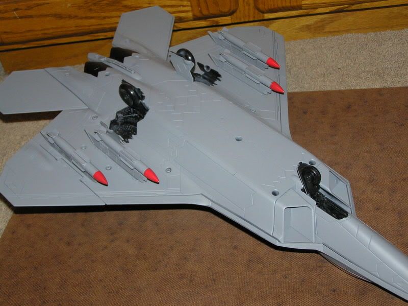

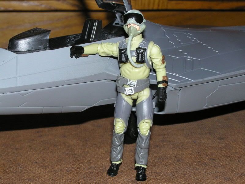

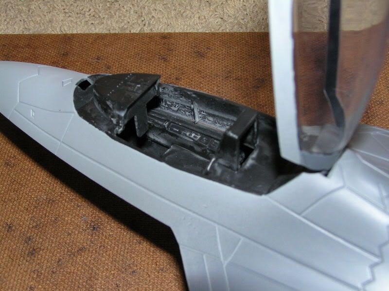

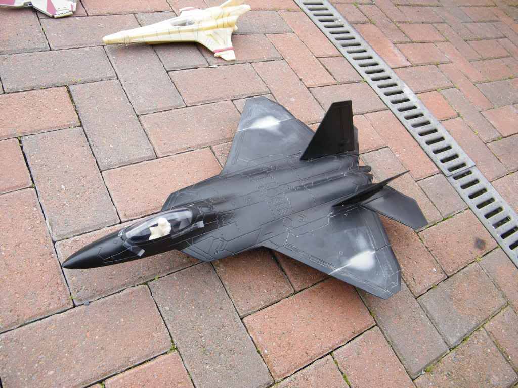

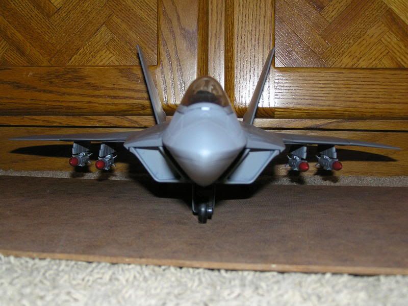

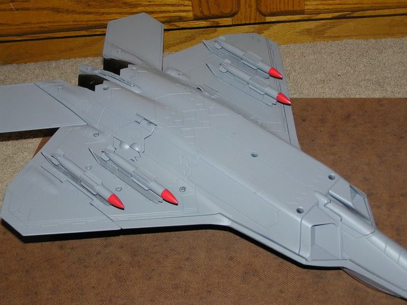

These aren't Britt Deitz quality, but here are a few photos of the PTE/True Heroes F-22. I am in the process of customizing the plane and it has been repainted from its solid black stock form. I have yet to add national insignia and unit markings.
I'm going to currently use it for my 25th Anniversary GI Joe figures, but may eventually rework the plane into a proper 1:32 scale model. It is most certainly 1:32 scale as a 1:18 figure (in this case, my custom GI Joe Ace figure) is way too large standing next to the plane. The construction of the plane is pretty good for what it is. It is quite solid. The landing gear retract very nicely and the exhaust nacelles are quite detailed. Cockpit detail leaves a little to be desired, but it is not too bad. The ordinance mounts to wing hardpoints, which I believe the F-22 can actually make use of.
Enjoy the photos 8)

It honestly doesn't look that bad, especially painted like that it looks pretty darn great. Aside from the overly disporportioned cockpit, it's the largest Raptor I've seen yet aside from super expensive RC or Wood models.
Thanks for posting the photos! Keep posting updates of your repaint, would love to see how it turns out!

It looks pretty good next to that F-4. I might pick one of these up. :D

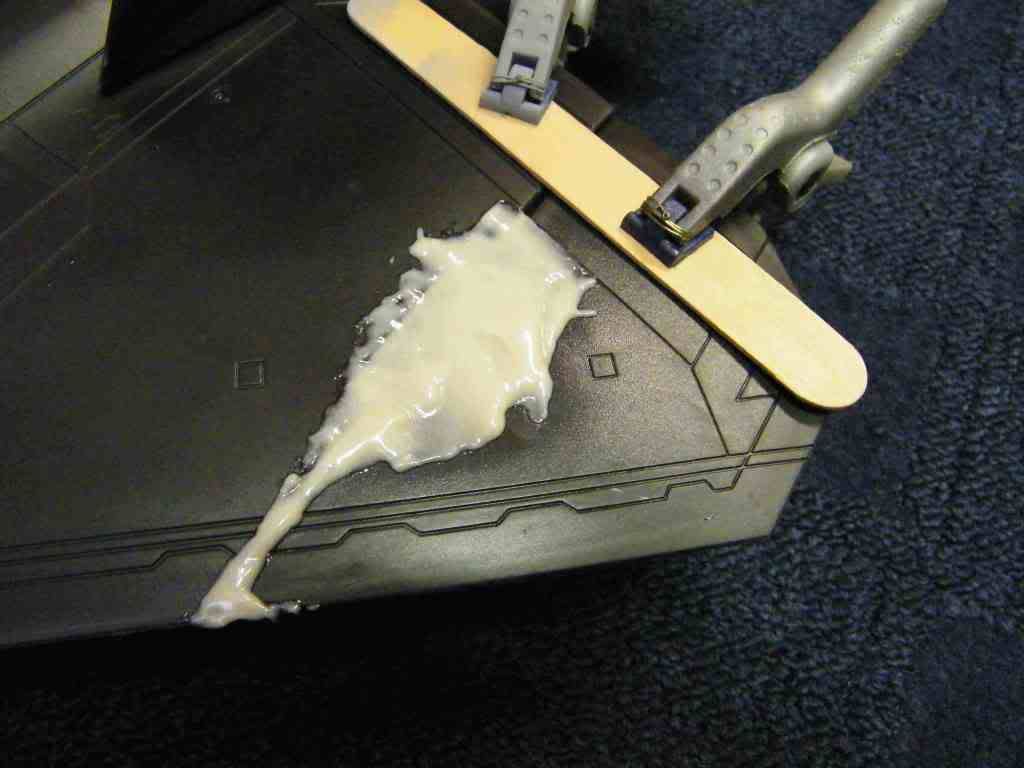

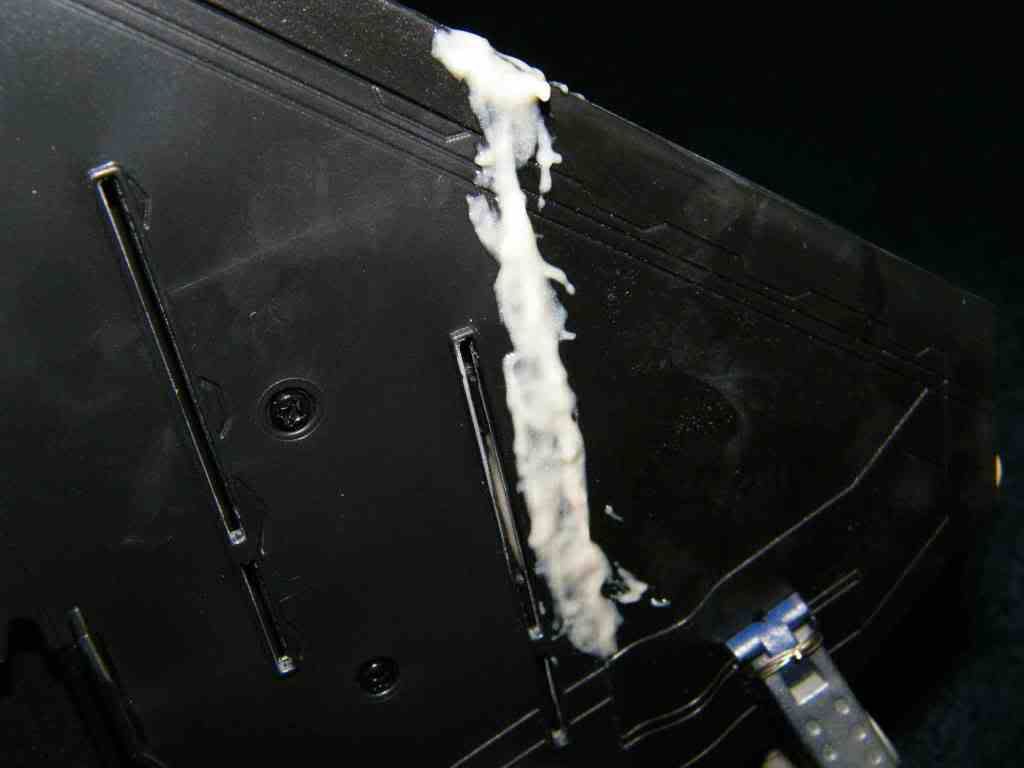

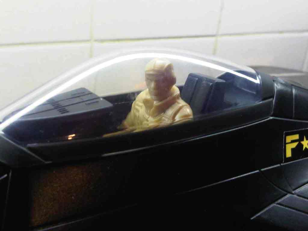

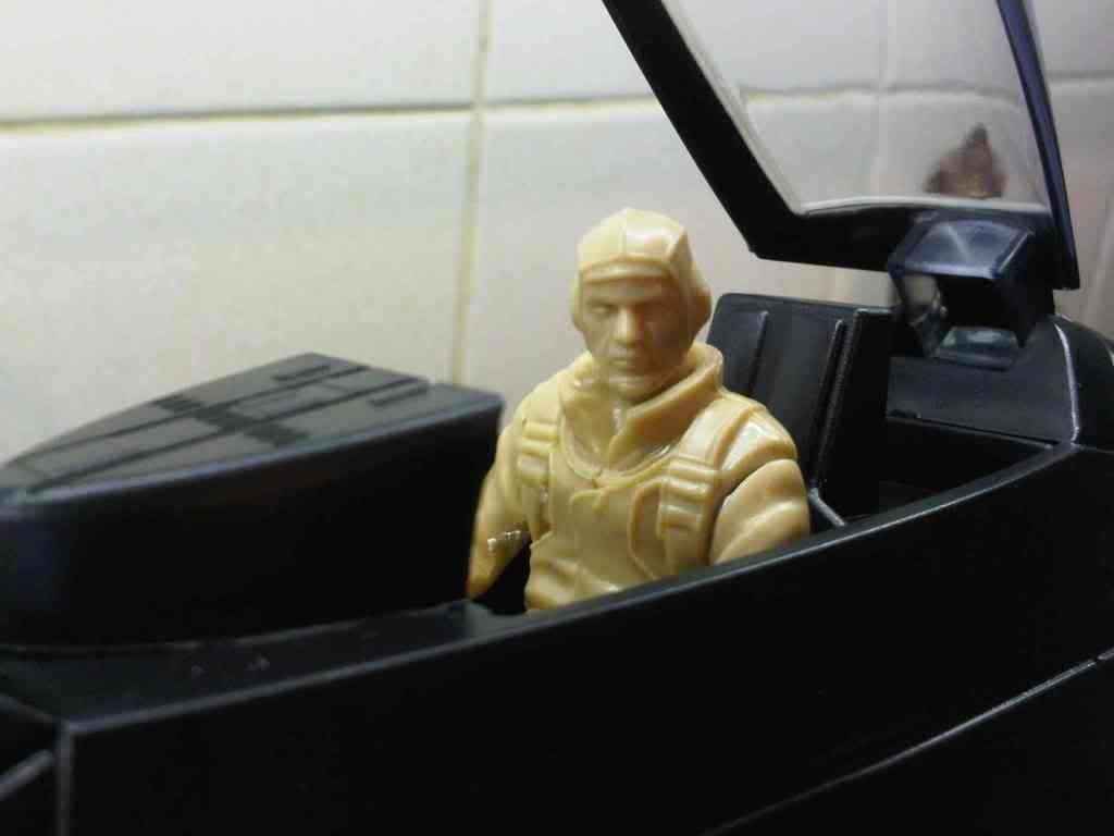

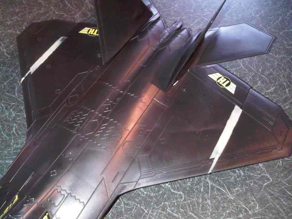

Okay.
Here goes.

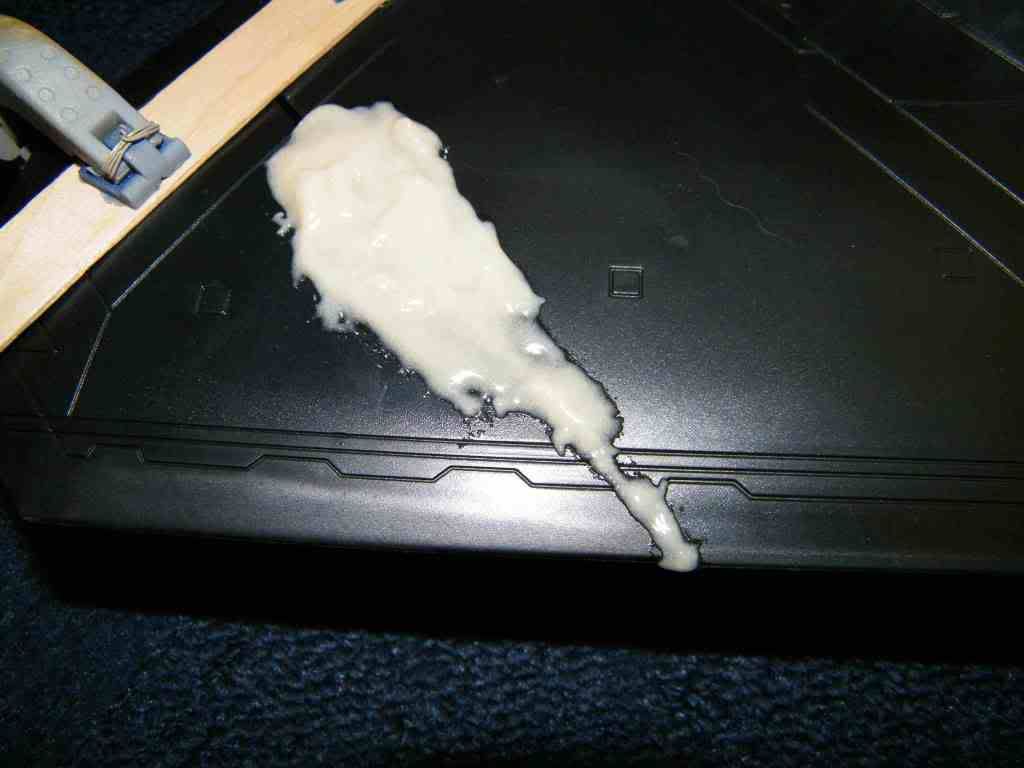

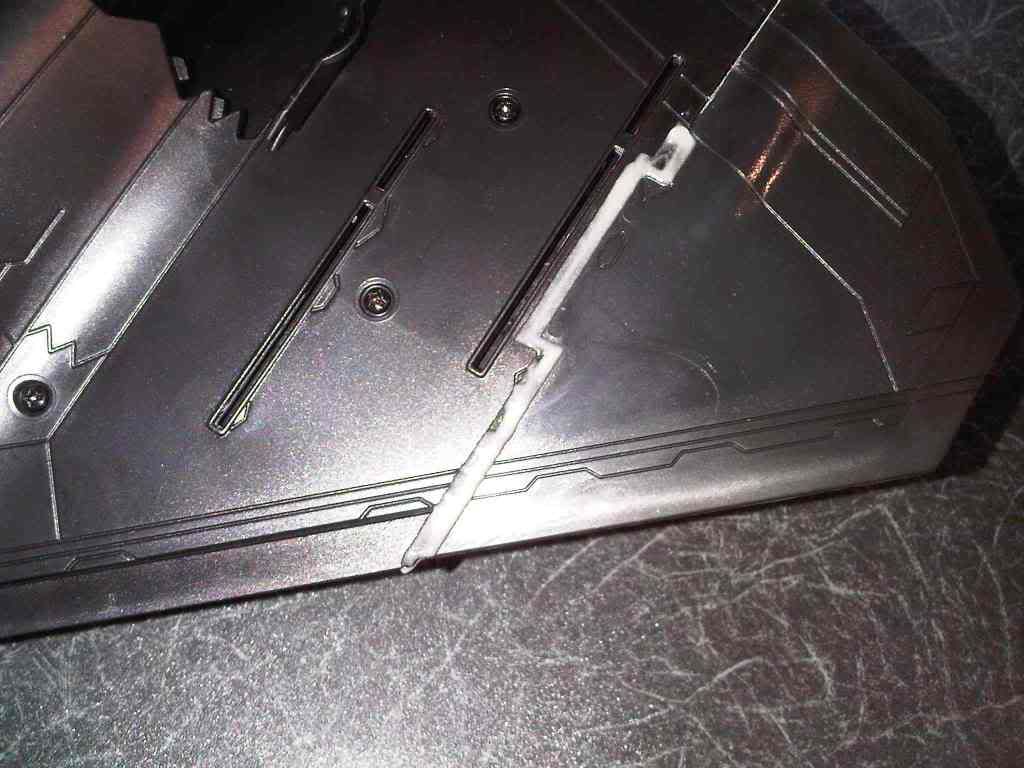

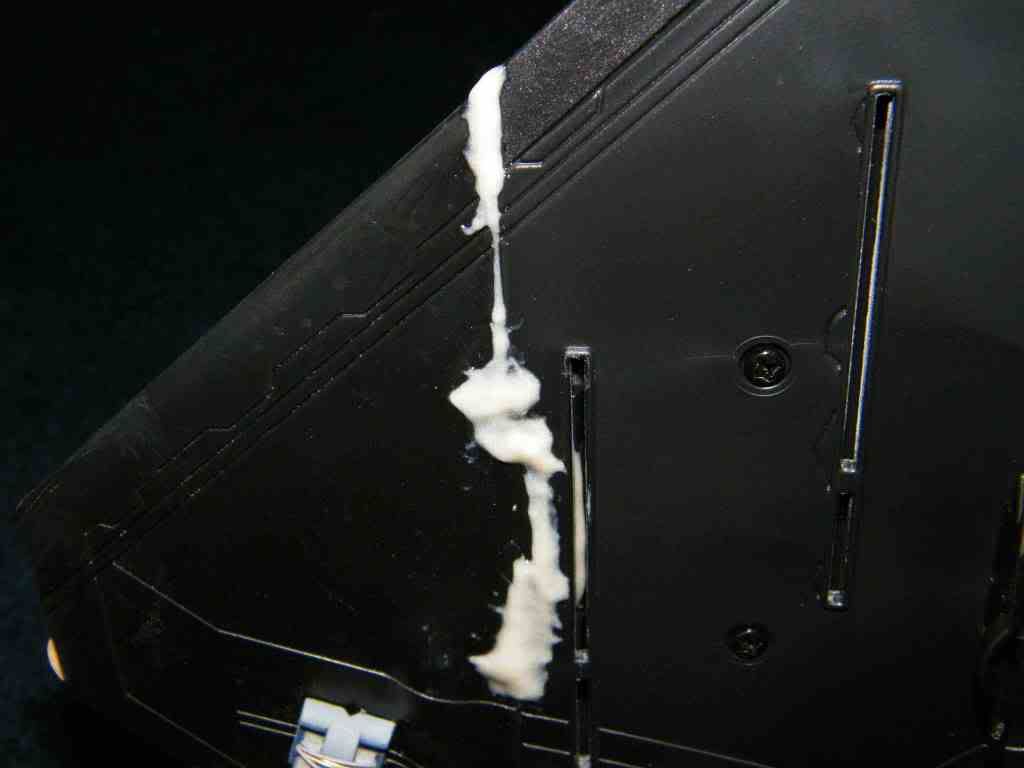

The figure is from a Hasegawa Model kit in the Maschinen Kreiger universe. He is in a WWII-style flight suit with a skull cap(But i just like the look!).
Anyway, here are pics of the filler i added on the top and bottom surfaces to hide the wingtip joint, and also a couple of closeups of the unpainted pilot in the cockpit:

I think it will make a big difference (on the plus side) with the gaps filled in once you paint it. I've decided to leave the gaps alone as my son would probably knock off the tip of the wing playing with it anyway, this way I can just put it back on and not worry about re-filling, sanding and painting again. Although, I did take off the armament pylons and fill those gaps.

Sweet.
I have a lot of good reference for Raptor colour schemes from the US military galleries.
I have plans to accurise the landing gear slightly. The current gear sits the plane too low to the ground. I will attach a mount into the "gear doors" as they are, and make longer more accurate gear that can slot into place when the doors are down.
Also, as regards the durability of the wingtips(for kiddie play), i just picked mine up by the wing ends and TRIED to break the tips off by swinging the plane around by the tip. I couldn't... It also has a certain amount of elasticity, so it gives slightly without breaking the molecular bond of the parts.
So Apoxie Paste is stronger than you might give it credit for. I never used any other adhesive. Just Apoxie Paste smoothed into the gaps.

Thanks for the tip about the Apoxy paste. Unfortunately for my Raptor, the final paint is already on. I'm just adding the last few clear coats to it now so not going back to the beginning on this one. Besides, I have a pavehawk Picklehaube upgrade to do to my BBI pavehawk.

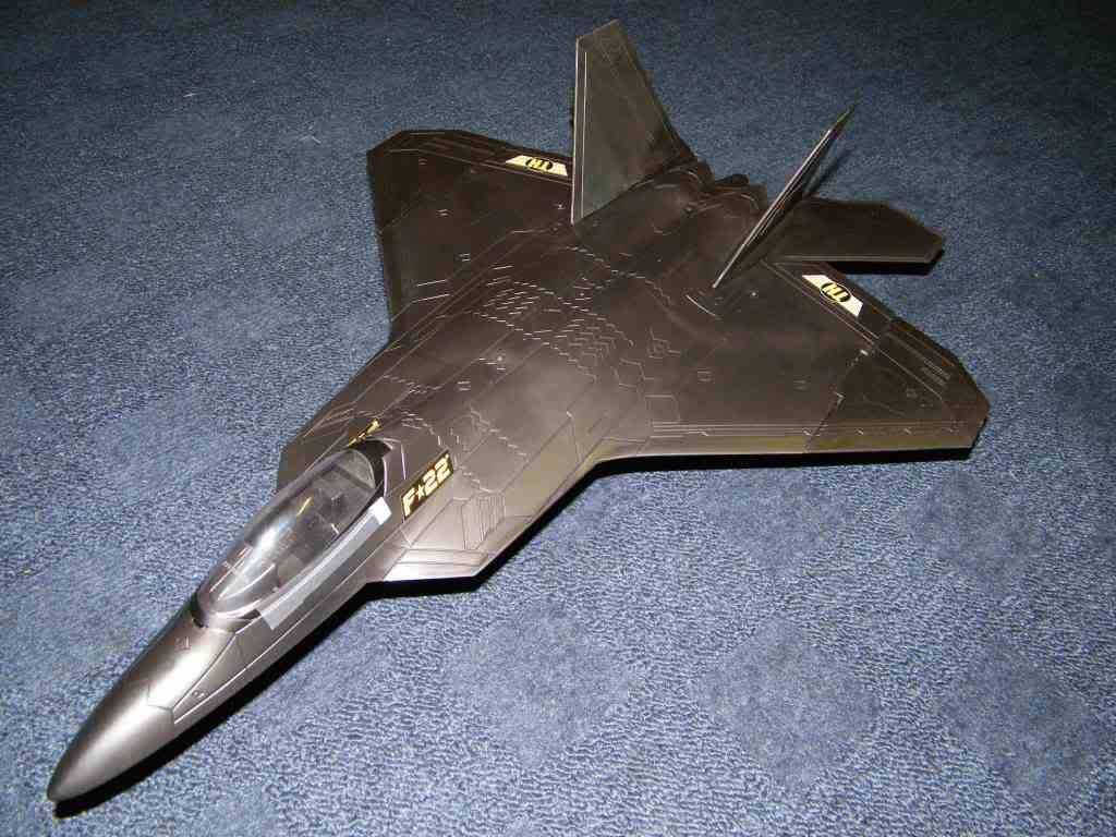

I finally finished this repaint. My son got this for Christmas last year so I'm only 8 months late getting it repainted for him. I was in a hurry so didn't use the airbrush as I didn't want to spend time cleaning between shades - I know the spray cans cost me more but didn't have to clean up.
It was the first time I used the "tint" black spray and I know it came out too dark - maybe one day I'll strip it off and redo it. It didn't look that dark until I took the masking tape off.
I used 4 shades of Grey and a final top coat of Satin clear to get a "little" shine as the pics I was using as a model all seemed to have a little shine to them. I also added a HUD and decals in the cockpit as well. I also know I didn't "sand" the armament rail holes well enough so don't beat me up over that.
First what I started with.

Ok. No pics right now, but a small update on mine.
I sanded the Apoxie paste flush with the wing and found a small dip on each side. I have since applied a NEW layer of paste to fill the dip.
i should get it sanded on friday and i'll be set to add primer to see how it looks.

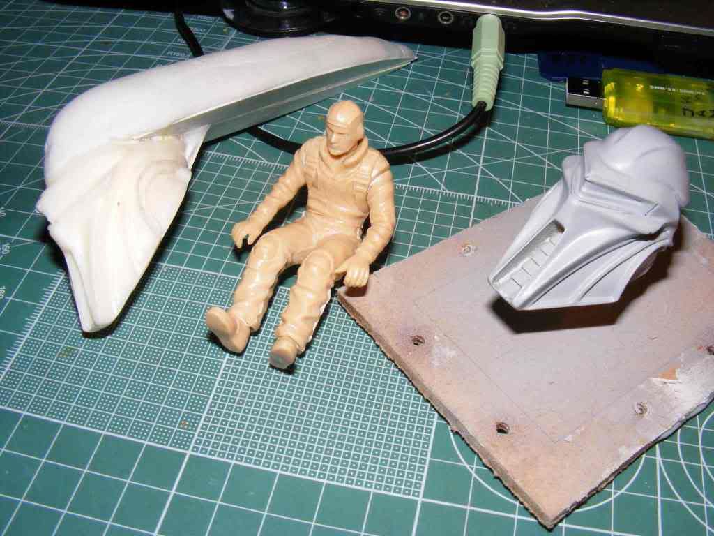

Post by Bar » Mon Sep 21, 2009 2:03 pm
paulpratt wrote:@ BAR,
Can i ask where you got the Mk VII Viper?
Sure.
I made it.
It's not 100% accurate, and i never got around to making the guns, the engines or the landing gear, but it's decent enough.
I have LOADS of WIP images of how i made it if you want me to PM them to you, but here are a few of the build:

The reason being that the canopy on the grey one is smoked nearly solid black.
Although the real F-22 is slightly tinted to allow virtually no light to reflect, you can still see in the canopy.
Also, by epoxying the wings as i did, it makes the joint between the parts virtually unbreakable.
It's totally solid on the one i made and painted above, and the seam is invisible.
Just some things to think about!
