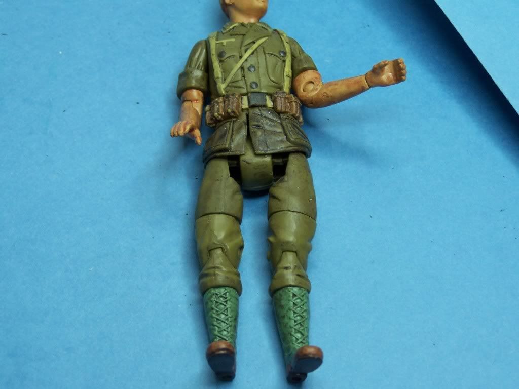

If you look at the Indy figure the thighs are about 3/8 in apart. Most of the 21st figs are only 1/8 th of a inch apart.
This is how you can rework it.

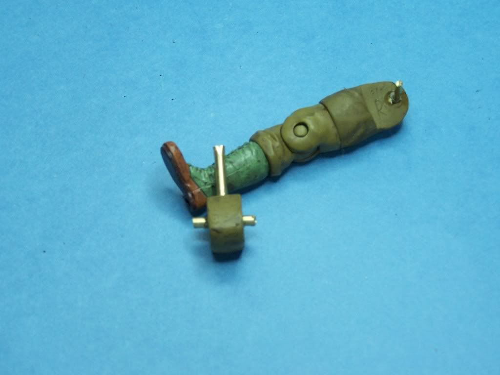

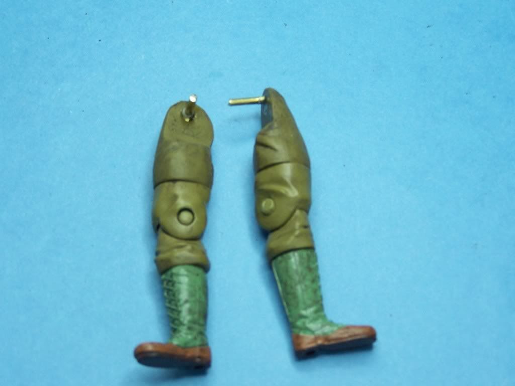

I have some brass rod a tubing that I get from Ace Hardware. a 1/16inch rod that fits into a 1/8 tube..
Pull the legs off the fig.the legs have sockets . Peen the end of the 1/6 brass rod flat and put a tiny bend in it. To fit in the socket.
CA glue the bent end in the leg socket.
Trying to work on the pelvic area resulted in it popping off. No big deal I drilled out the abdomen and pelvic area and used the 1/8th tubing as the pin . Then I drilled out the pelvic area to accept the 1/16th leg pins. To make a kind of an upside down "T "
Slide in the leg pins to the "T " and push up into body.The tunic hides the area nicely
Here is the fig on the bike. IT TOOK LONGER TO FIDLE WITH THE FIGURE THAN TO DO THE MOD.
It only about 1/2 hr to do this . No measurements. I just looked at the Indy fig as the guide.
Try it it is easy to do. :wink: :D
