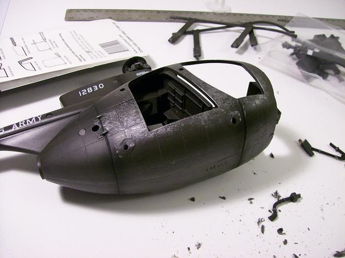

Disassembling a Little Bird was interesting, but I managed it without destroying anything I needed to reuse. The canopy glass is glued and screwed on, and the scew is almost impossible to reach beneath the floor without splitting the body in two. I managed. Most of the pieces came apart with a minimum of profanity from me.
The more research I did on Hughes/McDonnell Douglas MD500D helicopters, the more I realized how much would have to be done to the Little Bird. My wife calls this level of detail fixation "geeking out". I assured her it could be worse. BBI got the basic shape right, but let's leave it at that.

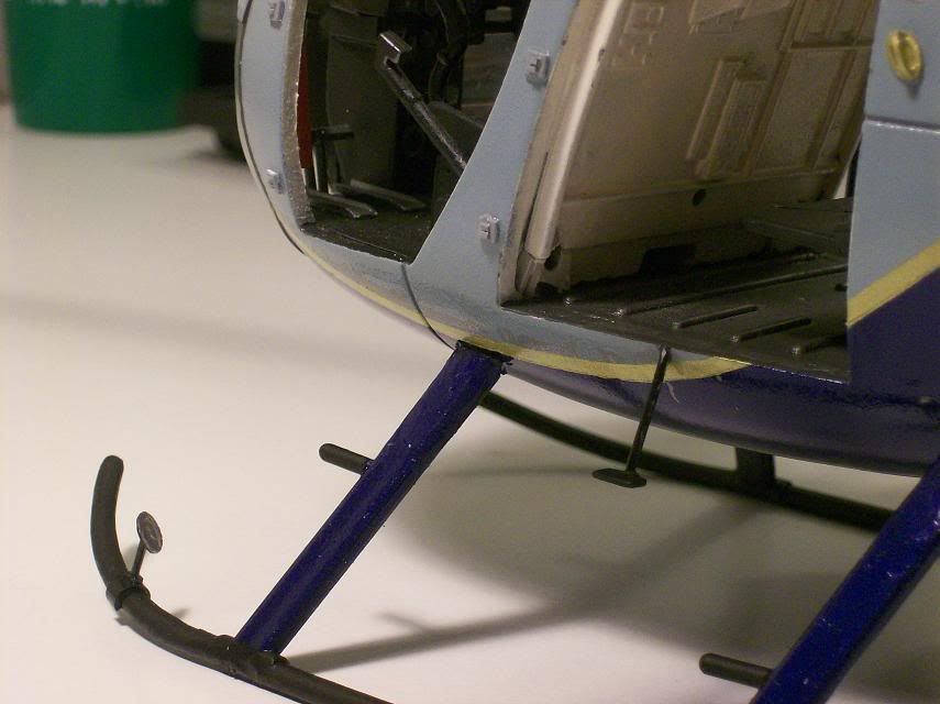

The skid mounts were the first things I went after. The BBI bird has bulging mounts which i had to shave off, which in turn will require some work to the skids themselves.

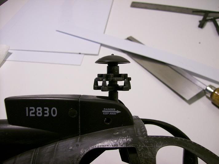

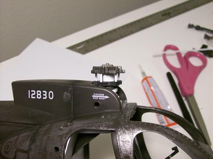

Next, the rotor mast is too high. The cap is also too far above the blades and the swashplate assm. is too wide. I took the whole thing apart, and without getting too "geeky" I rebuilt and cut down the necessary parts. (The metal shaft that everything rides on had a bit of play in it up and down. I hadn't pulled it all the way up in the second pic.)
The swashplate assm. is supposed to fit a little inside the rotor fairing. As it was, the stock assm. wouldn't even come close, being too wide, which might be why BBI made the whole rotor assm. too tall in the first place. Actually, most of the rotor parts are a little too big. I cut down the swashplate and built new linkages, cut down the height of the rotor base, and cut down the base of the rotor cap so it sits closer to the rotor hub (not shown in pic). It ain't perfect, but it'll do. The blades themselves may need some work on the bits attaching to the hub too, but I'll deal with that later.

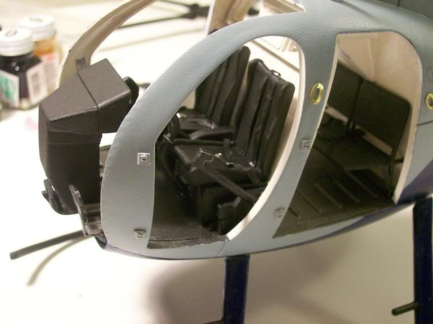

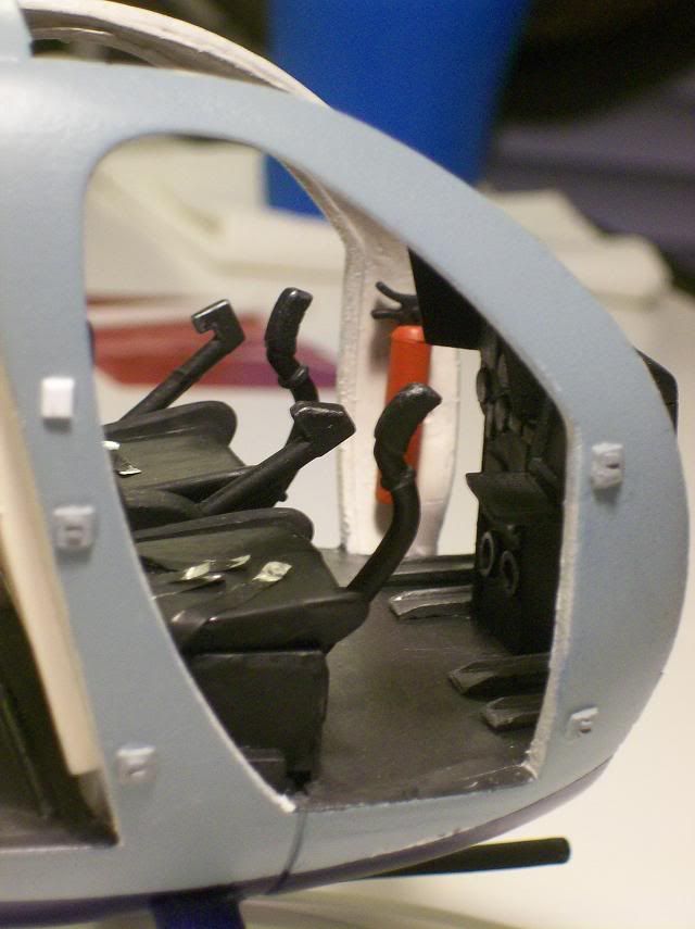

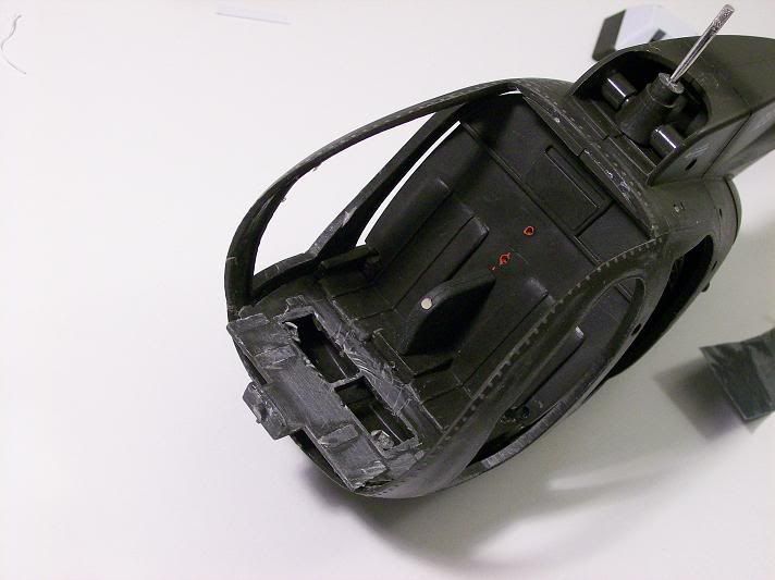

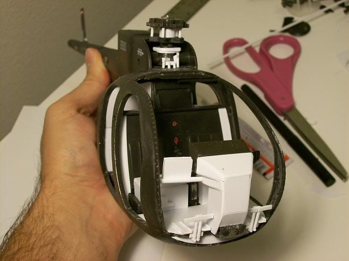

Next, the cockpit. Oh boy was this off. Bad. Everything had to come out. The seats are on the floor, which is wrong. the cyclics are mounted on some sort of island in the middle of the floor---wrong. The instrument panel is a flat piece of plastic with gauges and a hood. The foot petals were flat pieces of plastic and the collectives were WAY to long. The right side collective was also mounted too high. So I started ripping it all out. I had to cut the weird little island out of the floor. The front glass had this big attachment points that fit pegs halfway up the inside of the front cabin frames. I cut and sanded all of that off---they were a bit too obvious. I think the glass will glue on just fine without them.

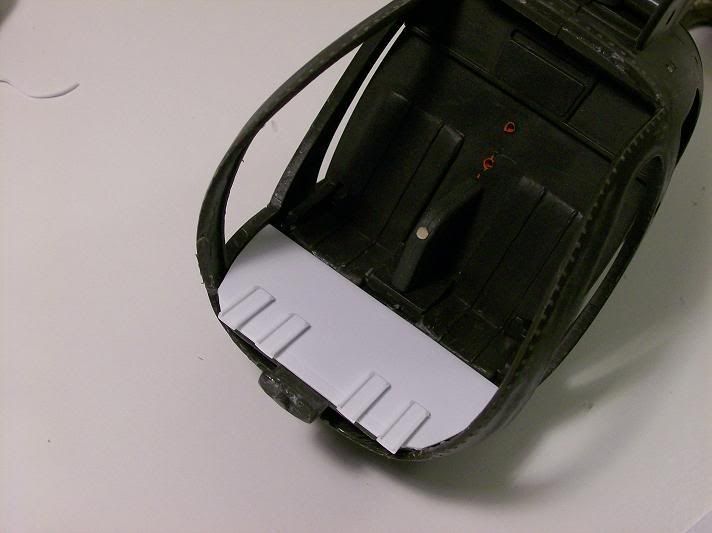

Next I replaced the floor for obvious reasons with thin styrene sheet and made foot pads for the petals.

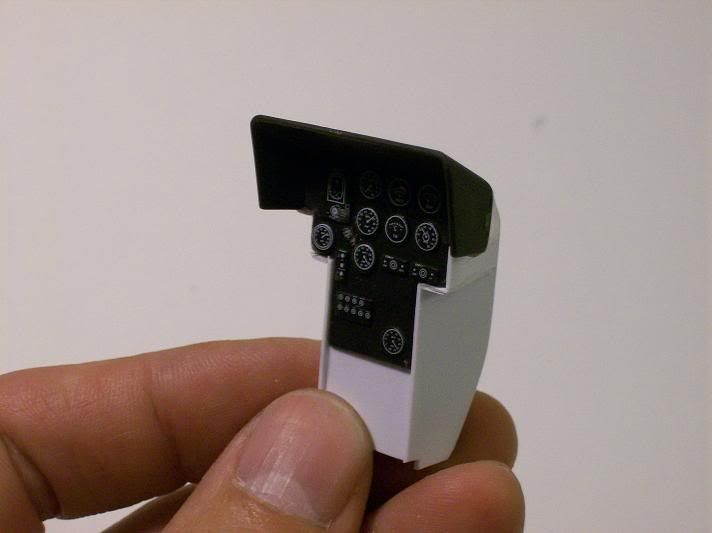

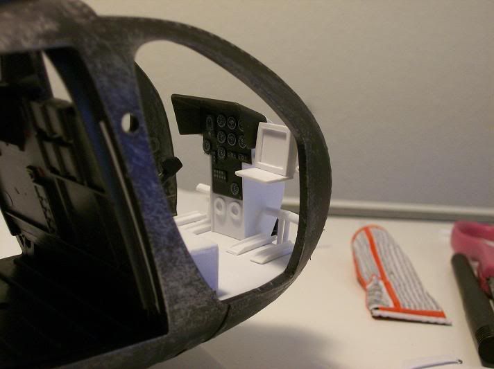

I figured I could reuse the instrument panel, because scratch-building the whole thing scared me. I used styrene sheet again to build it.
Now boys and girls, 500 series helicopters have been produced since the sixties, with a ridiculous number of models, configurations, and options, but I don't think there was ever an instrument pedestal produced that looked just like mine. At this point I'll make the disclaimer that all of the stuff I'm doing to this helicopter will be CLOSE to reality, but definitely not EXACT. Maybe I could, but I don't think my patience would allow me to.
Next was the foot pedals.

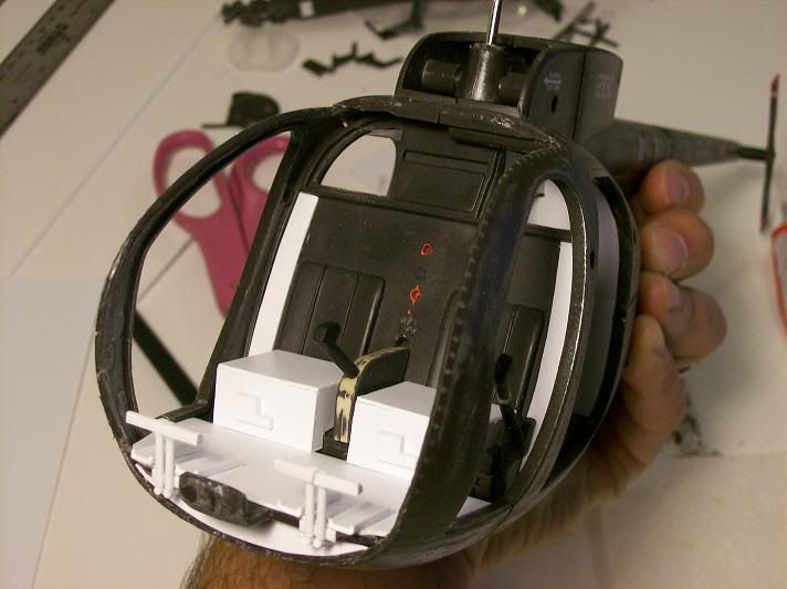

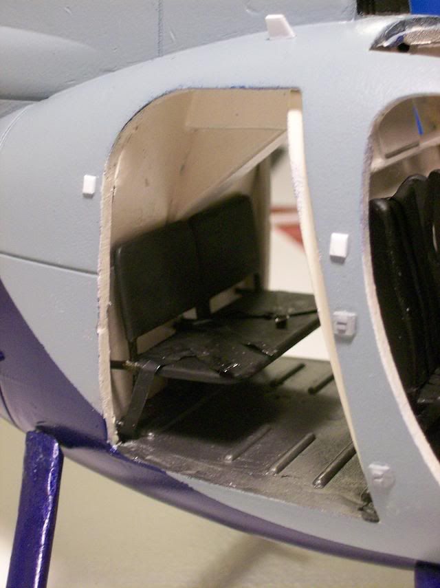

In the pic you can also see I built the seat bases and closed up an annoying gap between the front bulkhead and the frame on both sides. There are a lot gaps in this thing, actually. I had to clamp and glue the front floor down before adding the styrene because it was flexed upwards so much. In the pic you can also see I cut the two openings in the bulkhead behind the crew's heads. This was lots of fun and I only cut myself twice. The little "L" shaped bits on the front of the seat bases are where the cyclics are actually supposed to be mounted.

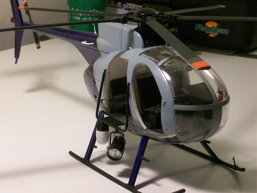

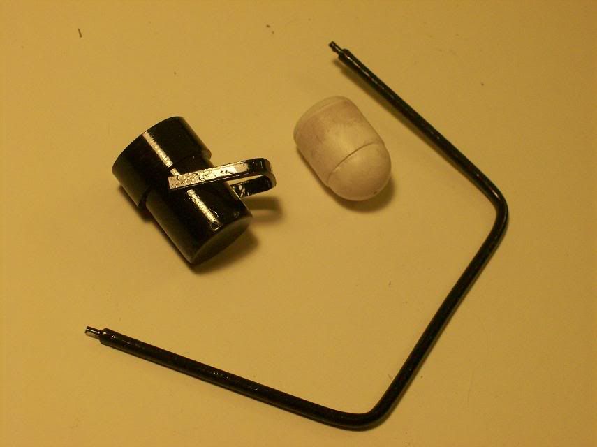

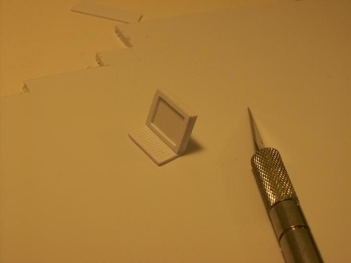

Most police helicopters nowadays are equipped with all sorts of electronic goodies, including a monitor and keyboard for the right hand seat. So, I needed a monitor and keyboard:
I mounted the pedestal and ran a piece of styrene tubing from there to the wall, and mounted the monitor on that. There are a bunch of different mounting methods I've seen on real helicopters, but this one was the easiest.

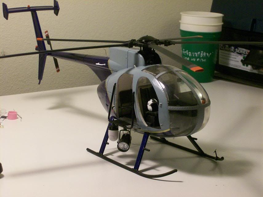

In the first pic you can see the modified rotor assm. again. I added a bit of the linkages that protrude upwards in front of the assm. It ain't all that accurate, but reproducing the real thing would have taken me about a month. I will later add a cable cutter right in front of the rotor assm.

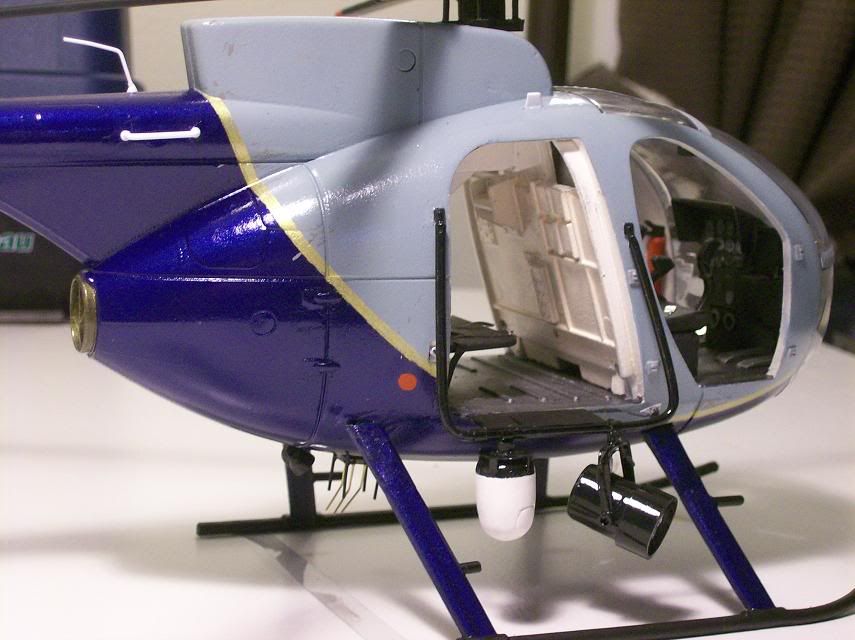

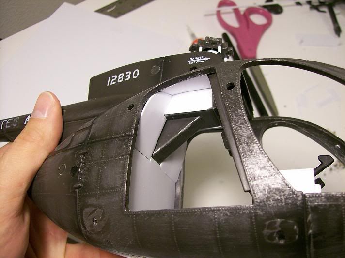

The rear of the cockpit got some attention too. Gaps everywhere. The only thing I could do was close it all in with styrene sheet.

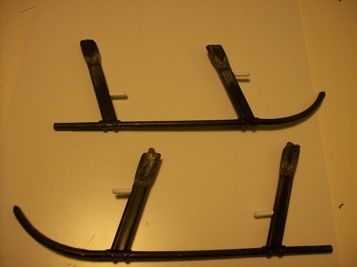

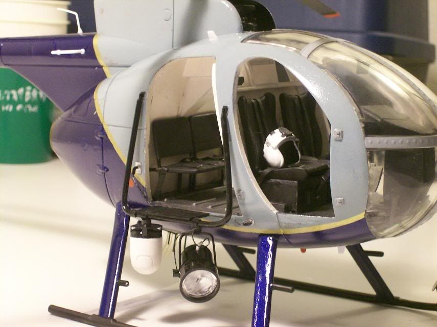

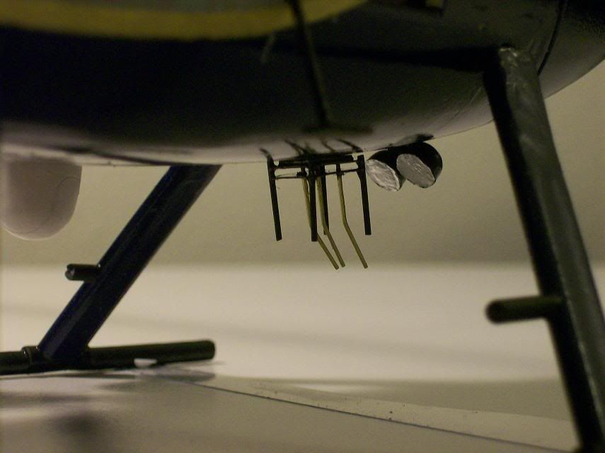

Next, the skids. Like I mentioned earlier, the mounting points needed to be adjusted because the body mounting points were cut down. Luckily, this involved removing material and not adding it. Always easier to remove. The fairings at the top of the skid legs were a bit too bulky and were cut down, as well as the bottom attachment points where skid and leg meet, although I hadn't yet done it all when I took the picture.
I also added the foot pegs with styrene rod.

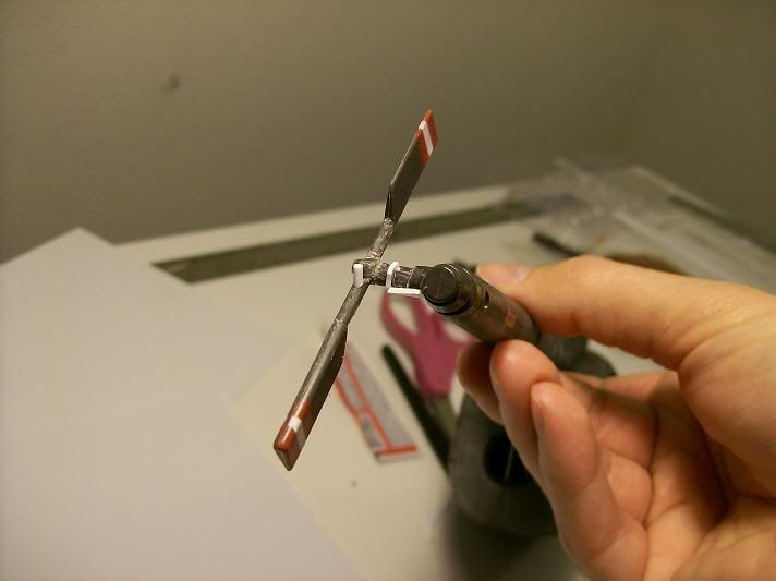

Tail rotor next. Way too bulky and simplified. I shaved some bits down and added the largest and most obvious parts of the linkage. I thought about adding a twin cascading rotor assm. but decided against it. I'll likely do more work to this part but I'll need some smaller styrene rod.
