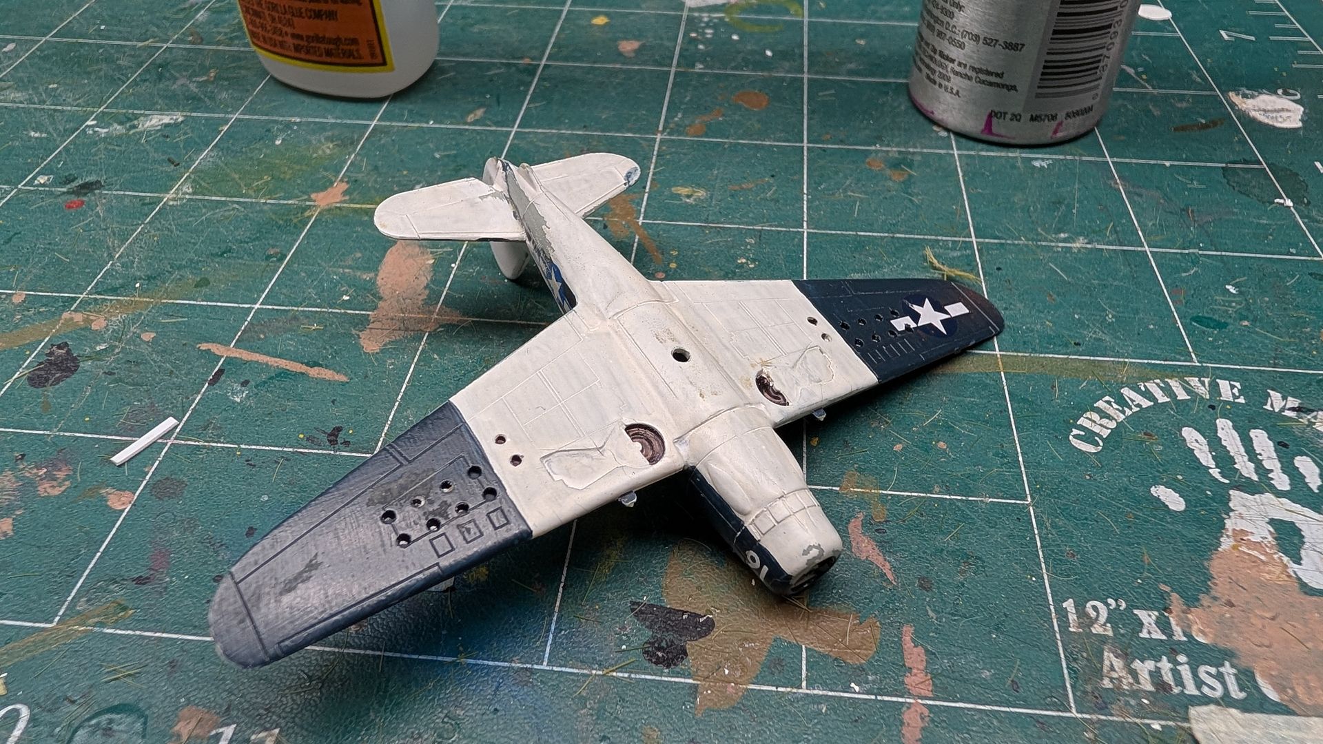

Not being satisfied with working on just ONE plane, I purchased a Johnny Lightning Corsair off of eBay that was missing the engine cowling and prop.
This one would be reborn as the CAF's one and only FG-1D Corsair.
Always up for a challenge I knew I could work with this. First thing was to cut off the centerline bomb rack and bomb. Then I used a Crown/Minicraft B-25 engine as I have some spare Cobra B-25 engines I will probably use eventually for those. I also used plenty of putty to cover the screw holes, seams, etc. I also used an aftermarket radial engine to put in the hollowed out cowling.
After some sanding and primer work, I shot it with dark navy sea blue, and need to go back and do a few touchups before proceeding.

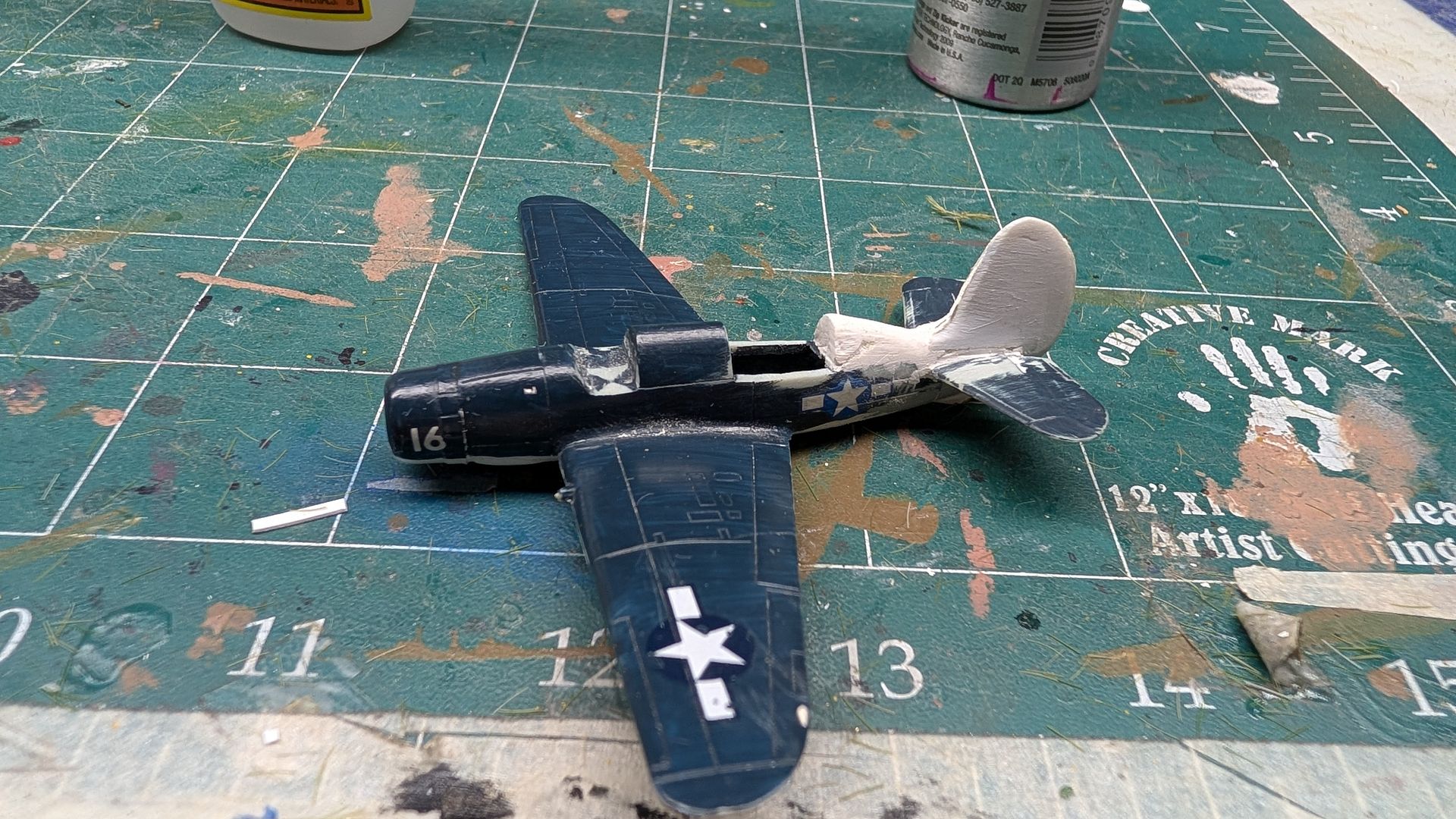

After some sanding and a primer pass, I was ready for dark sea blue. The first pass wasn't great and required some sanding down of paint bubbles. A second paint pass was okay by me. I then started in on the markings. Which was kit bashed from multiple decal sheets and extras.
The checkers were a pain to say the least. I'm going to try and touch up the induvial checkers with some blue and white paint, but if I cannot salvage it, then I'll start again. I might have to cut out the checkers I need, and then hit it with a coat of decal bonder before soaking it.

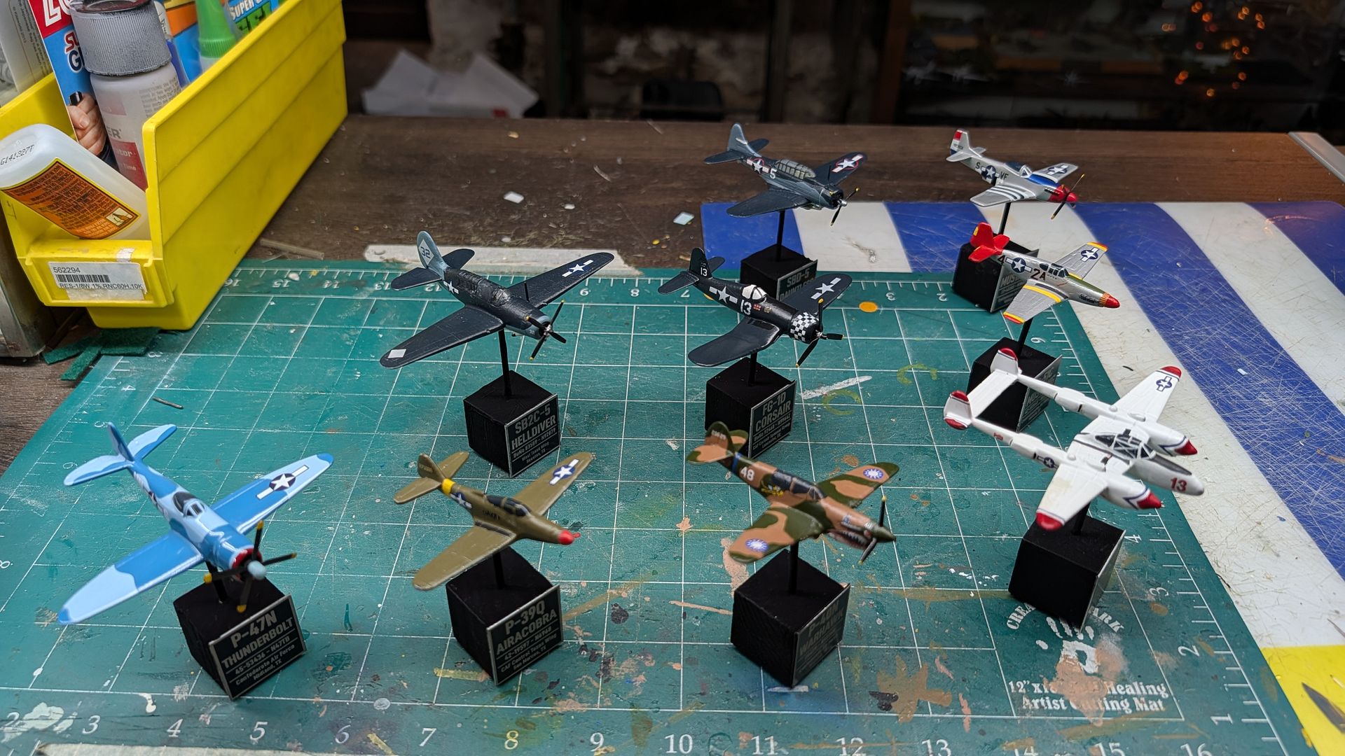

Here are the finished birds so far.
Next in line is the P-38.
I will start to paint the canopy in, walkways, etc. basically anything I can do before decals. And then there is the next one...

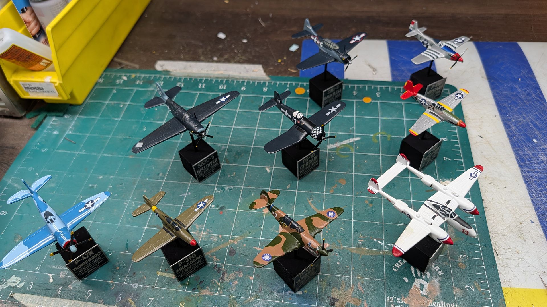

And with that, the P-40 is finished...
The dark glossy sea blue I've been using for all the cockpits (except the Corsair) is to keep the consistency with the Corgi P-51 and P-47. It blends in a bit too much more my liking but it is what it is...
I used a model master enamel tan and Vallejo green from the RAF paint set. The bottom was just pure white.
The Chinese nationalist rondels were sourced from a post war P-51 decal set. The tigers were from the AFV P-40B/C kit. All the numbers were from the always reliable I-94 decals. The shark mouth, pandas, and kill markings were custom printed. I painted the blue band on the rear fuselage.
I had to bridge the two shark mouth decals with some paint and little bit of touch ups. Once I was satisfied with the overall result, I coated it in a satin clear to mimic how the real one was more shiny for easier maintenance. Though I still may go back with a flat coat.
This now puts me at six completed CAF fighters. I still have one more to complete before I think I'll move on to something else. Still working on the bases for these.

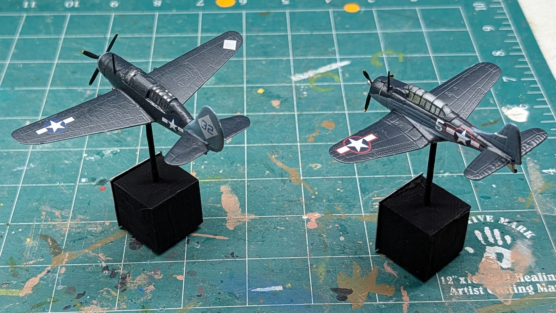

I've recently finished up a few more for this series...

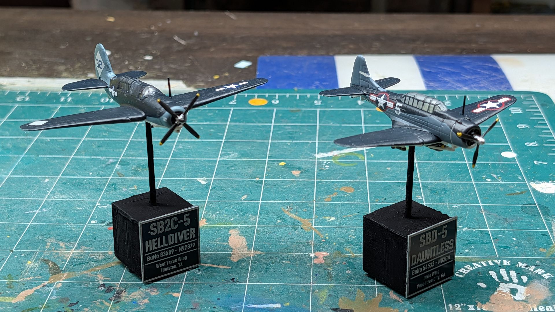

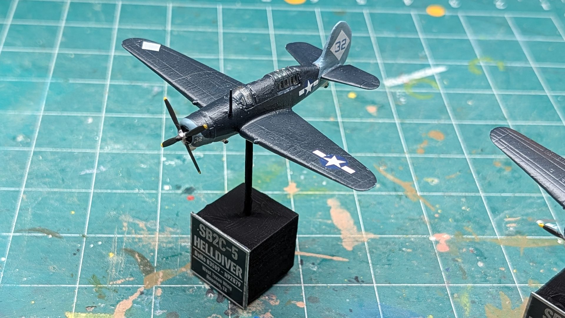

SB2C Helldiver
The CAF's Helldiver has been the only game in town for decades attending shows across the country. It wasn't until a year or two ago that two more Helldivers were restored to fly as well. AND their are even still a couple more that are being restored to fly. So we might eventually see 5-6 flyable Helldivers in the world...
The kit is the ancient and wildly inaccurate 1975 AHM model. This was the ONLY option for decades if you wanted a 1/144th scale Helldiver. Of course now we have the added luxury of SB2C models from: Cafe-Reo, F-Toys, and now a 3d designed / printed example from China (off of Evilbay). But for me this is the kit I had in my drawer and one that was part of the original group that my father had built for me. Though he never had finished it, that didn't stop me form playing with it.
Once again I forgot to start taking any shots of the model before I started...

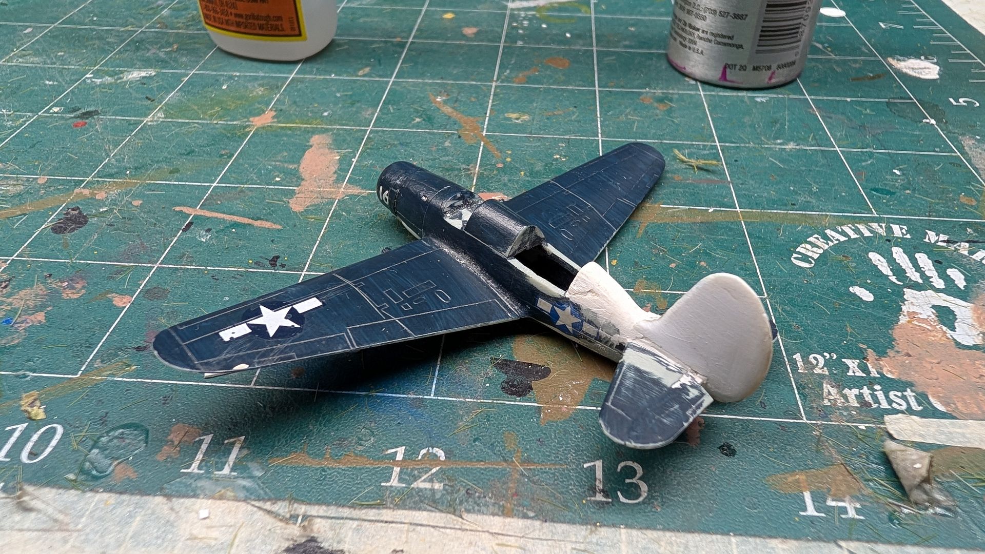

By the time I took these shots I had already started addressing the tail which was too small. I had some thin styrene sheets and essentially "laminated" them over the existing tail by gluing them in position, then adding putty to fill in any gaps, and started shaping it by sanding the new tail.
I also built up the rear gunner's area with more putty and sanded it until I thought it looked pretty good. Another major issue with the kit is the double wide cockpit area where it looks like two pilots could sit side by side! This was something I wasn't ready to try and fix, and decided to leave it.
I was able to find the original cockpit glass and I believe the original prop from the kit. I was able to utilize a spare rear gunner's greenhouse glass from a Cafe-Reo SB2C since they came with an extra canopy. I also added the missing tail wheel, exhausts, radio mast, and the small intake scoop on the underside of the nose bowl. I made the USS Franklin decals for the tail and printed on my home printer decal paper. The stars and other numbers are just kit bashed.
The result? Not bad but of course not the best given the medium I had to start with. Still with the goal of giving these old kits a good retirement after they gave me such joy over the years, I say it was a success.

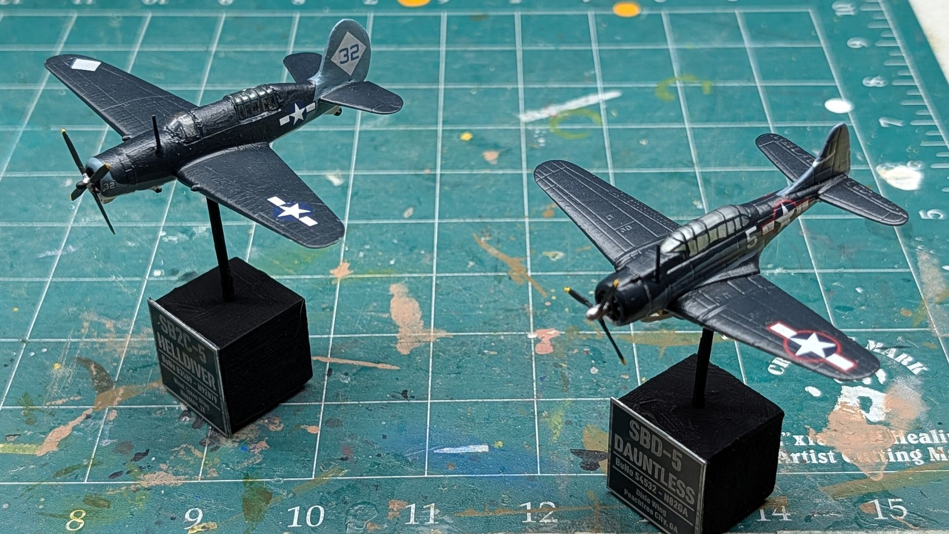

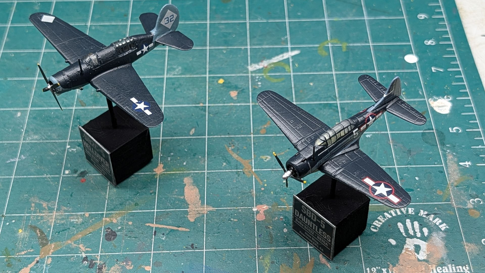

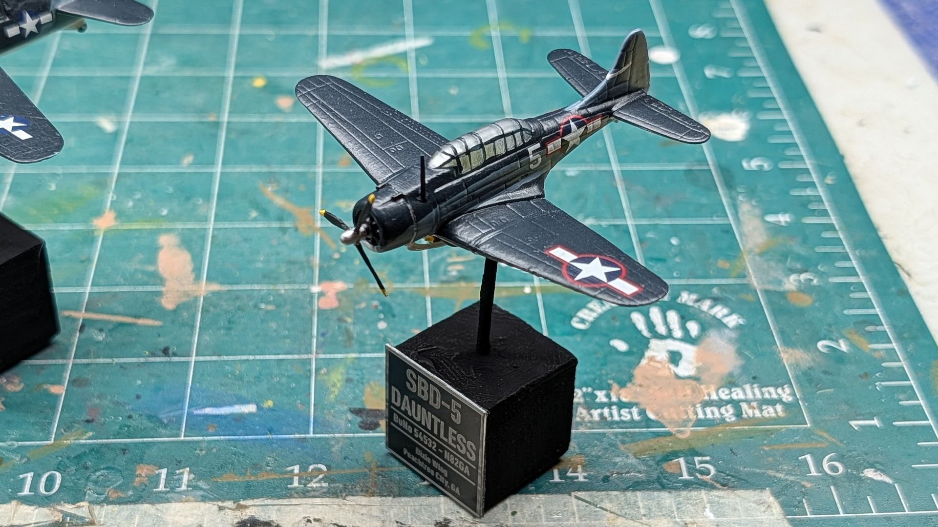

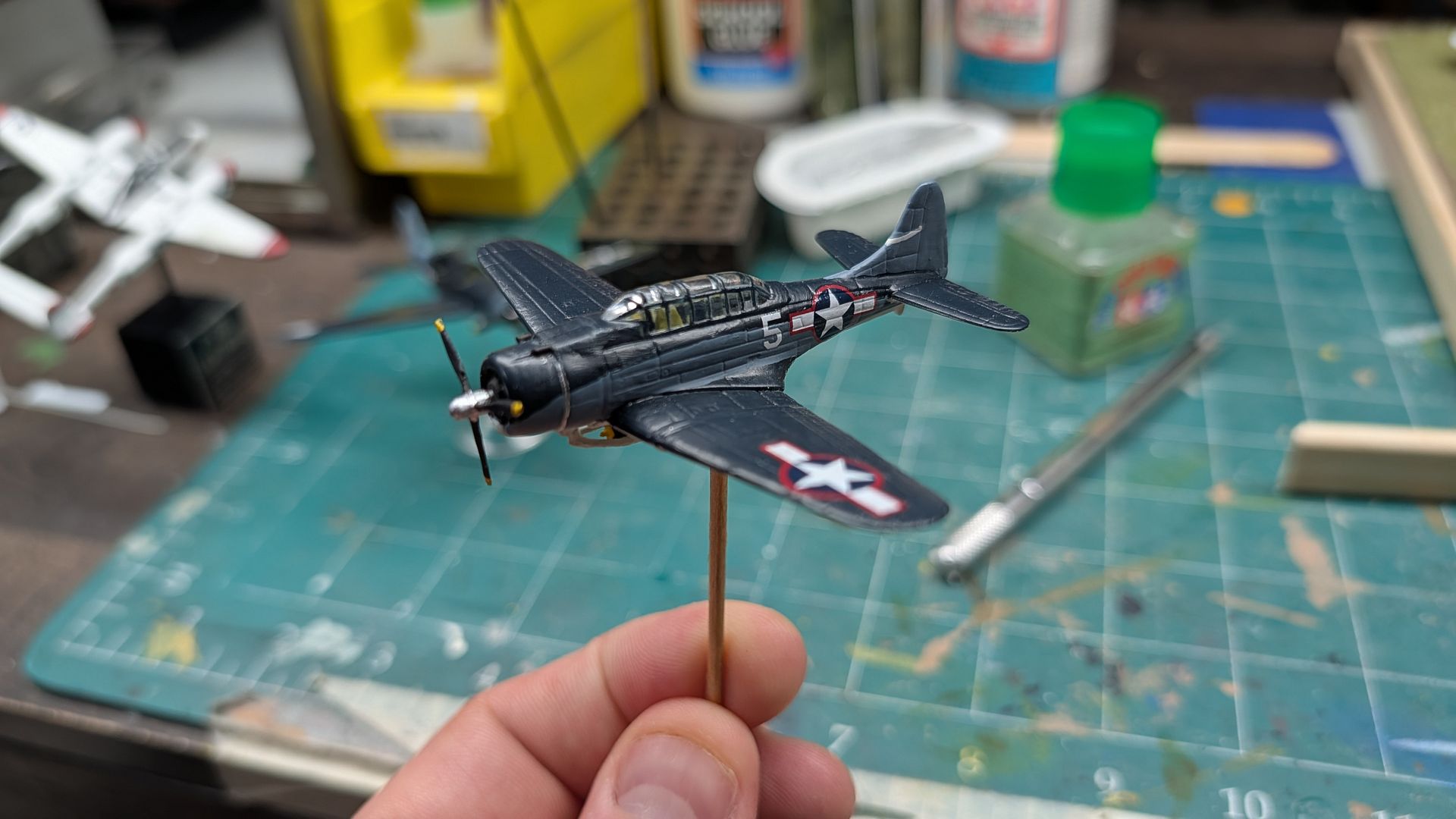

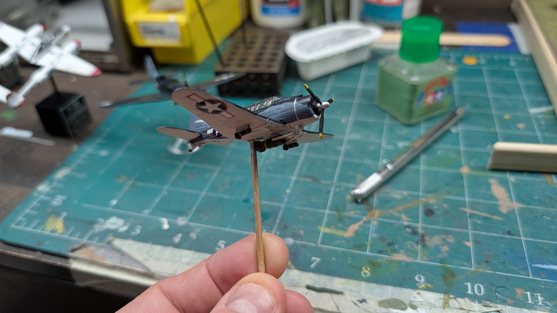

SBD-5 Dauntless
The other one I ended up making was the CAF SBD-5. Another mainstay in the CAF fleet.
Now this kit was NOT from my earlier childhood, but it was also not too far off. As this started out life as a 1/144th scale 21st Century Toys model that could have been bought in Walmart back in the day. Needless to say when these first came out, my father and I were scouring every local store we could for these and did end up buying a few... so there were more than a few that were played with... this being one. This started off as a Coral Sea / USS Lexington example that had lost it's landing gear and bombs at some point.

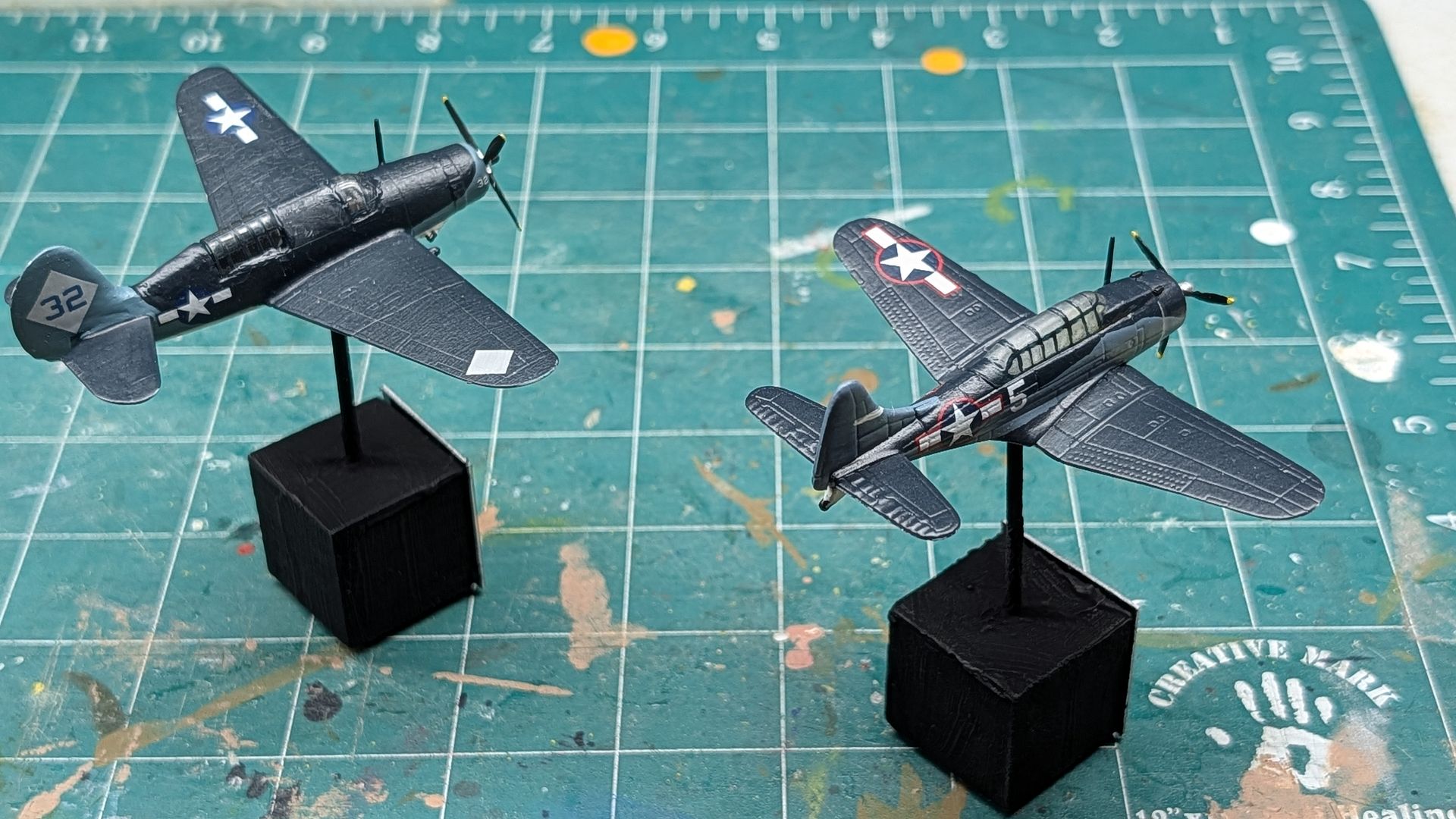

And of course I didn't take ANY in production shots. This one was pretty straightforward. I ended up adding putty to fill the large cavity space between the engine and firewall area. I sanded it smooth and brush painted the tri-tone colors on. The decals were kit bashed once again.
I added guns in the nose and the radio mast. I had the original lading gear but it just wasn't working to put them in the up right position. So I used a couple of very small rubber O-rings with some styrene rods. I then filled the center of the O-Rings with super glue and painted. I was able to reuse the original bombs and repainted them to match the ones on the real CAF SBD. I finally sprayed the entire thing in a flat coat which fogged up the glass somewhat which was my bad. Wish I had took the time to mask it. Something to remember next time.
And with that the two CAF dive bombers are done!

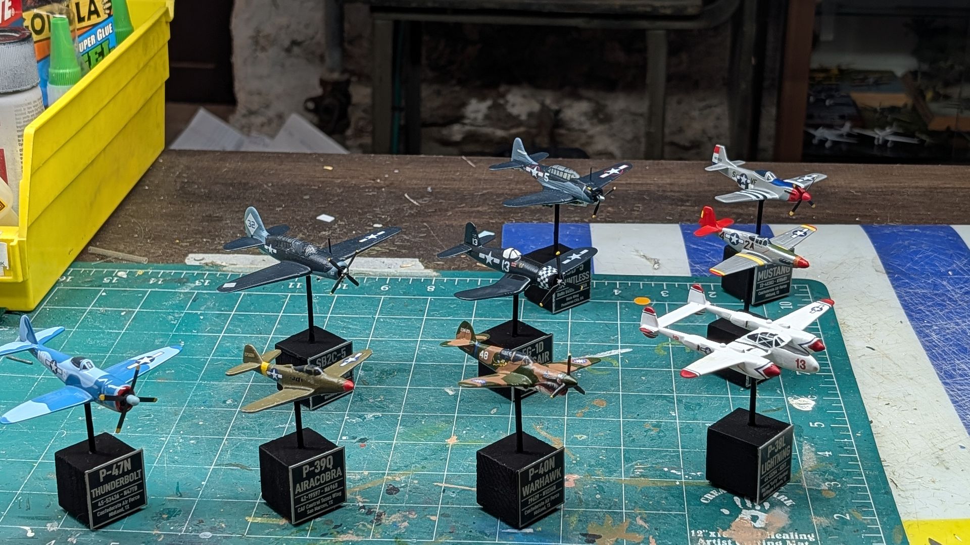

This brings up the collection to nine aircraft total! The P-38 is the only one that still needs some touchups / details before it gets clear coated and finished.
Now this doesn't include the CAF bombers that are on there own landing gear and not these black stands. One day I'll take a shot of all of them. Hope you enjoyed!
