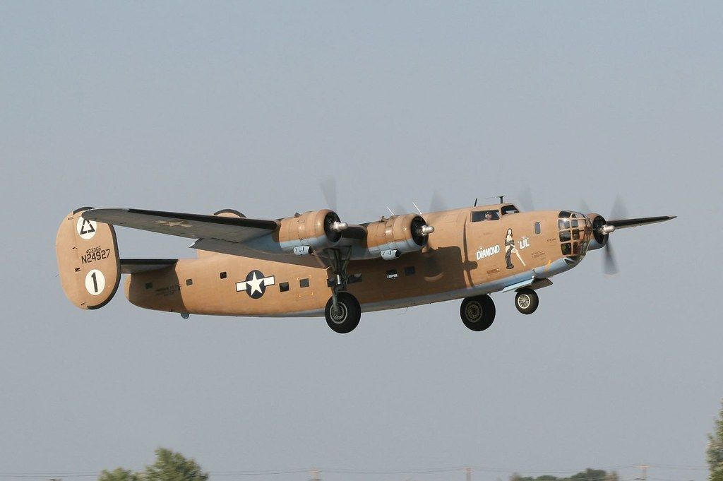

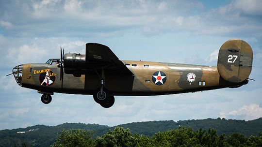

This is how she appeared more-or-less for the better part of four decades while being operated by the Confederate Airforce. By 2006 the ole' girl was looking pretty beat up and the B-29/B-24 wing of the CAF (renamed Commemorative Airforce) decided to reconfigure and repaint her back to a more authentic B-24A condition. Led by their chief maintenance officer at the time: Gary Austin the aircraft's tail gun position, and starboard waist gunner window were rebuilt, in addition to decking over the rear bomb bay, bomb racks, flight deck windows above the pilots, and other authentic items were installed. She was also given a new name: "Ole 927" in honor of her original UK serial number. With a more authentic paint scheme indicative of the early pre-WWII aircraft, this 24 now looks much more accurate.
A couple years later the CAF Wing decided to change the name back to "Diamond Lil" as it had some significant brand recognition. While they haven't yet removed the "canoe" tub section and reinstall an original bomb bay back into the plane, that will take some time and money. Not to mention removing and sheeting over the side cargo door, running all the flight control cables back in their original location, and opening up the upper gun hatch just aft the wings. Hopefully updates I'll see in my lifetime.
