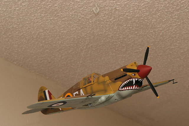

Post by Panther F » Thu Dec 27, 2007 3:27 pm
Thanks for the close up pics of the white #7 262. Mine should be here Jan. 3. I've never seen that version of the P40, I have the AVG:
I did the same and super glued the knot and looped it around the hook so that it couldn't slide. Great idea with the white hooks! I may have to re-arrange mine soon and the white hooks will have to be used!
Nice pics!

Post by Panther F » Thu Jan 03, 2008 3:05 pm
I did get my ceiling ornament today:
