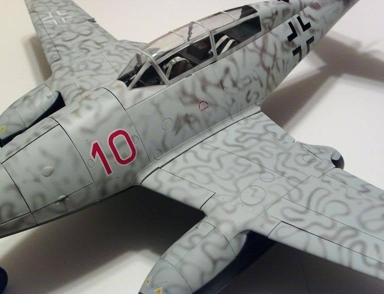

If you go for it, I'd copy the style of 21st's Me-262 night-fighter canopy.......that seems to be the way to go.
What if I do the front landing gear strut just like the 262 as well ?
I could use the main wheel to and maybe get away from that cartoonish huge front wheel.
Of course I would have to make the strut longer. That way it would be more realistic to were the front wheel will fold back.
Opinions ?

Pickel, something like this?
or would it look like this with a smaller nose wheel?
Would the angle of the aircraft change? I'm confused..... :lol:

No need for a pic. There will be a wire that will go into the main tube of the strut onto the top of the tire.
This may not work I also could make a tiny triangle piece of stock and glue it behind the strut under that lower ring. The little triangle will sit tight onto the tire. This will hopefully brace the whole thing.
That is something I will have to address when I get time.
I think that I like the Me-262 main gear strut rather than a smaller wheeled version of the original main nose gear.
Opinions ?
