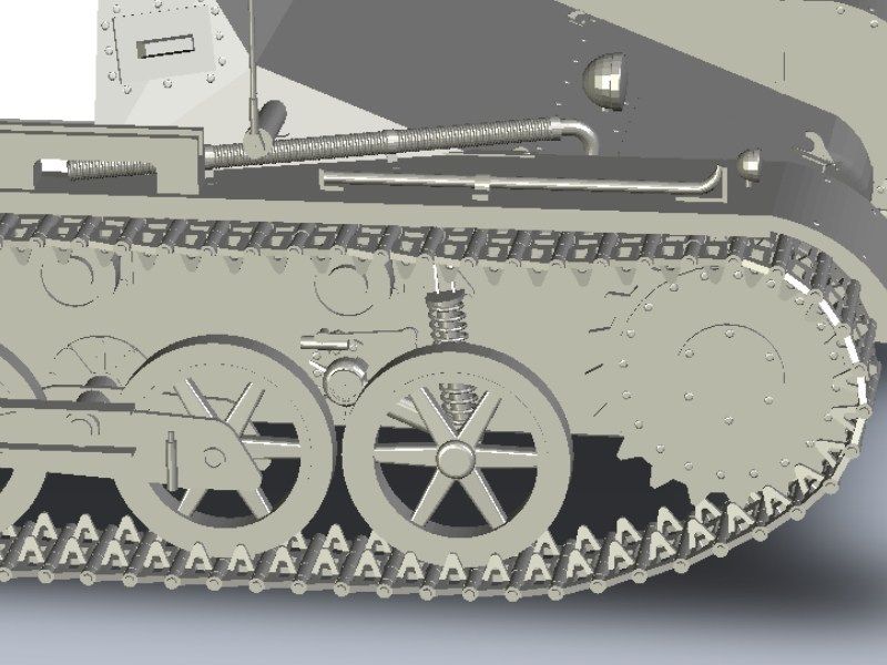

Weldone! Looks like a nice CAD and 3D printing work. If I may say, I would recommend to focus your attention on how round are the wheels (in case you are planning to reprint the wheels or keep it in mind for any future CAD projects). Wheels seem to have angle-steping which should be smoothed with sandpaper now, while it could be easily avoided if CAD designed properly to create a smoother digital wheel model. If it is just the picture which makes it look like this, please accept my appologies for misunderstanding.

This is why the first set of wheels on the Panzewr I were more polygonal than would be ideal and you as you noted they are not as round as they could be. They've become rounder as the model has progressed which you can see in the photos. The first approach I used was to try and increase the resolution of the existing mesh. In theory it's easier to do that than rebuild each part. That helped, but was far from perfect. It made some impact that you can see in the difference between the first pictures and the later pictures. The back of the turret had the same problem.
I ended up rebuilding the parts. The new ones are not on the model yet. Once I figured out a quick way to do the curve and surface rebuilds, it turned out to be easier than my original "beef up the part resolution" method.

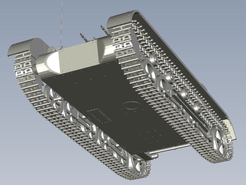

They are glued together, but could easily be click together. I don't think click would hold them together very well, at least not with the printer I have and at this scale. The next project will have an option for pins, but it will be a Shapeways print.
The tracks are made of sections of link of various sizes eg: 1x, 2x, 4x, 6x, 8x and 12x which you can see somewhat on the picture above. When assembled, the bottom and top are one long flat piece and I used whichever section lengths worked best to fill in the rest. The hanging parts are all 1x.
As for the wheels for those of you interested, this is the final rebuild process I ended up with that provides the smoothest curves.
