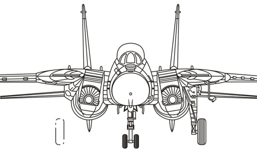

Has anyone tried fixing the tails not being canted outward yet?

vulgarvulture wrote:Has anyone tried fixing the tails not being canted outward yet?
Yeah that is nagging me too.
Now that spots are not on my table, I can think about how to fix that.
Plan A:
This could work but I would try it on something similar first with a painted finish. Once heated, using a simple jig (set at the correct degree matching the picture below) bend the vertical tail stabilizer just above its base. Since the stabilizers only cant a few degrees outward it shouldn't take that much time and heat to finish the process. The jig will help it bend properly while preventing it from bowing during the heating process. Again this idea works but I would recommend experimenting on a test sample first just to be sure the results match with what you want. I'm working on this myself and if all goes well I'll share with you all my findings along with pictures of the jig itself for better clearification.
See the video down below regarding the heating process.
Plan B:
Another idea is to just heat bend the tabs a bit. And with a little minor sanding along the under side of the base of each vertical stabilizer (so that it connects flush with the body after assembly) you should have it. This way you don't jeopardize the paint on each tail.
http://www.youtube.com/watch?v=gHLS3P820ZM

Post by CessnaDriver » Mon Jan 04, 2010 12:38 pm
I was thinking maybe building up the inner part with stryrene might be enough to angle it properly.
